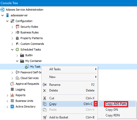

There is no need to perform a search. Use the below updated script. In the script, the $taskPath variable specifies the ADS Path of the Scheduled Task to be executed. To get the path:
  3. Navigate to Configuration\Scheduled Tasks.
  4. Right-click the Scheduled Task you need.
  5. In the context menu, open the submenu of the Copy item.
  6. Click Copy ADS Path. The Path of the selected Scheduled Task will be copied to the clipboard. image.png
$adaxesService = "adaxesserver.company.com" # TODO: modify me
$taskPath = "Adaxes://adaxesserver.company.com:28102/CN=My Task,CN=My Container,CN=Scheduled Tasks,CN=Configuration Objects,CN=Adaxes Configuration,CN=Adaxes" # TODO: modify me
$admService = $admNS.GetServiceDirectly($adaxesService)
# Bind to the Scheduled Task
$myScheduledTask = $admService.OpenObject($taskPath, $NULL, $NULL, 0)
# Run the Scheduled Task
$myScheduledTask.RunNow()
