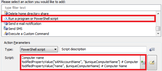

Have a look at the following tutorial: http://www.adaxes.com/tutorials_SelfSer ... dReset.htm.
On step 4 of the tutorial select Run a program or a PowerShell script, enter a short description and paste your script into the Script field.

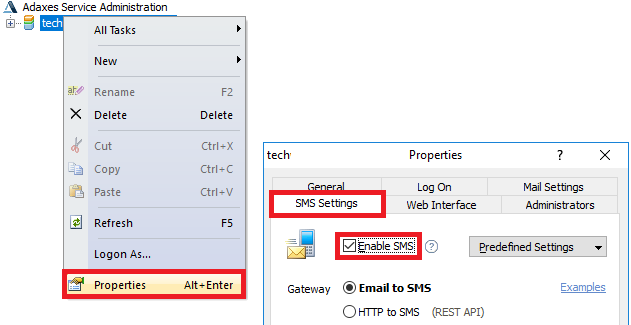

  8. Launch Adaxes Administration Console.
  9. In the Console Tree, right-click your Adaxes Service node and select Properties.
  10. Activate the SMS Settings tab.
  11. Activate the Enable SMS option.

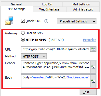

  12. Enter the following settings and click OK:
  • Gateway:
      HTTP to SMS
  • URL:
      https://api.twilio.com/2010-04-01/Accounts/<AccountSID>/Messages
    where is your Account SID you copied on step 1.
  • Method:
      HTTP POST
  • Header:
      Content-Type: application/x-www-form-urlencoded
      Authorization: Basic <AuthenticationString>
    where is the Authentication String you copied on step 7.
  • Body:
      Body=%smstext%&To=%%2b%mobilenumber%&From=%%2b<FromTelephoneNumber>
    where is the Twilio Phone Number you copied on step 1.
