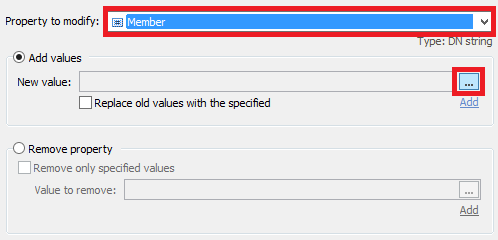

  3. On step 3, add the Update the Group action and click Add.
  4. Select Member.
  5. Click the Browse button embedded in the New value field.

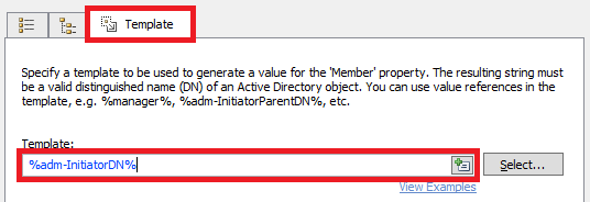

  6. Activate the Template tab.
  7. Specify %adm-InitiatorDN%. It is a value reference that will be replaced with the Distinguished Name (DN) of the operation initiator, that is, the user who launches the Custom Command.
  8. Click OK 2 times.

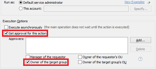

  9. Select Get approval for this action.
  10. Select Owner of the target group.
  11. Enter a short description for the script and click OK.

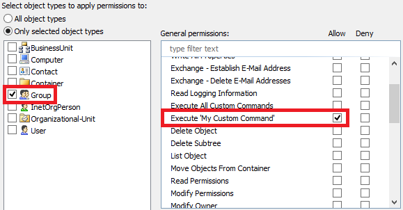

II. Distribute permissions to run the Custom Command
To distribute permissions to run the Custom Command that you've created on step I., you'll need to create a Security Role as follows:
  2. On step 2 of the Create Security Role wizard, click Add.
  3. Select the Group object type.
  4. In the General permissions section, select Execute 'My Custom Command', where My Custom Command is the name of the Custom Command that you've created on step 1.
  5. Click OK, and then Next.
