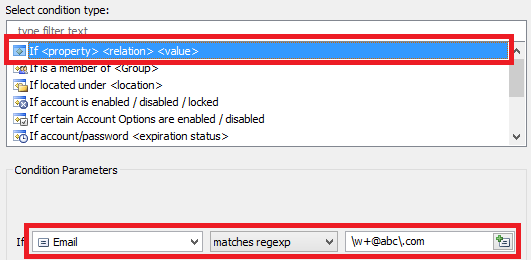

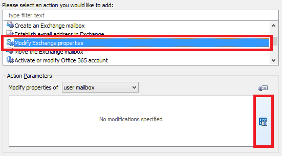

I've created a task that says "if the 'email proxy addresses' property contains '@abc.com', then
modify mailbox setting for the user: modify email addresses (remove 'smtp:%mailnickname%@abc.com')
which obviously works great if the mailnickname matches...but not certain how to remove the others.
Please let me know how I can remove all instances of email addresses that contain @abc.com from their SMTP.
