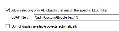

Currently, we are not planning that. Regardless of all the advantages, one huge drawback would be a tremendous effect on the performance.
Maybe we are talking past eachother ?
Currently we use "adm-CustomAttributeText1" to filter the users shown i lists.
Then, why can't we use e.g. "adm-CustomAttributeBoolean1" as filter, to only show users with that attribute set to e.g. "%adm-CustomAttributeBoolean1%=true" ?
- Thanks
No, you won't be able to use that. The thing is that if you use value references in the Web Interface configuration, they are resolved into property values of the currently logged in user.
Thus, in your example:
  • If a user whose CustomAttributeBoolean1 attribute is set to True logs in, the resulting filter is (true=true);
  • If a user whose CustomAttributeBoolean1 attribute is set to False logs in, the resulting filter is (false=true).
by (700 points)
