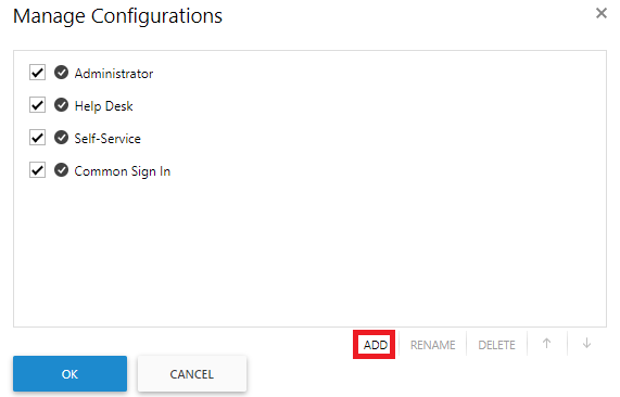

  2. Expand the drop-down menu in the top left corner and click Manage Configurations. image.png
  4. In the Name field, specify the Web interface name that will be used in its URL.
  5. Specify the Web interface display name and the Web interface to copy settings from.
  6. Click OK.
