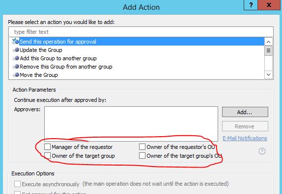

More approvers would be usefull when adding a member to a group:
+ Manager of the target user.
+ Owner of the target user's OU.
In some cases, a User manager can add a user placed outside the User manager's scope to a group, or a Group manager can add users to his group.
Adding a user to a group may give the target user rights to data, access to IT system, or may issue an invoice. In all cases, the target user's manager must approve membership.
