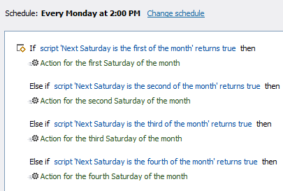

Is there a way to have a Scheduled Task with 4 different condition? I want to create a scheduled task start every Monday and the condition see:
The next Saturday of the week is the first of the month then take a action The next Saturday of the week is the second of the month then take a different action The next Saturday of the week is the thirt of the month then take a different action The next Saturday of the week is the fourth of the month then take a different action The next Saturday of the week is the fifth of the month then no action
Thanks in advance, Simone
by (530 points)
Hello Simone,
Yes, it is possible. You will need to use a scheduled task executed every Monday. In the task conditions, use the below script to determine whether the next Saturday matches the specified number. In the script, the $requiredNumber variable specifies the number that should be matched.
$requiredNumber = 3 # TODO: modify me
$date = (Get-Date).AddDays(-5)
$weekdayCalc = [int][Math]::Floor($date.Day / 7)
$weekdayNum = if ($date.Day %% 7 -eq 0) {$weekdayCalc} else {$weekdayCalc+1}
$Context.ConditionIsMet = $requiredNumber -eq $weekdayNum
Finally, the scheduled task will look like the following: image.png
