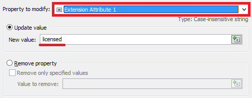

  5. In the Property to modify drop-down list, select Extension Attribute 1.
  6. In the New value field, specify licensed and click OK 2 times.
