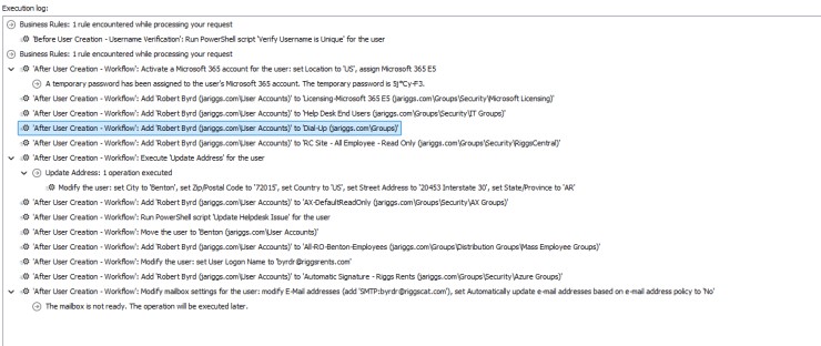

The issue happens when we run the create user action with the actions above, the process doesn't work. It seems to be trying to modify the email domain in exchange using the old incoorect User Login Name and it never actually works correctly.

We do not see any issues in your screenshot. The action worked exactly as configured. It just took the value of the Username (schema name userPrincipalName) property and set it as primary SMTP address. Also, you did not provide any insights on how the workflow should actually depend on the user department.
As you can see it, sets the User Logon Name to end in @riggsrents.com but when the final workflow runs, it sets it to @riggscat.com. Those should match. It should be setting the user logon name to @riggsrents.com based on department "Cat Rental Store".
The 2 steps later it should modify the mailbox setting to add the @riggsrents.com domain and set it as primary. This is the part that's not working correctly. Its adding the @riggsrents.com domain based on policy.

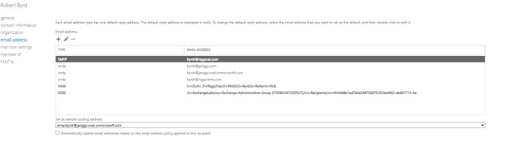

this is how it looks when finished via the exchange server. Screenshot 2025-03-07 101644.png

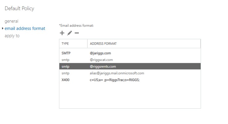

Here is the exchange address policy that's being applied: Screenshot 2025-03-07 101804.png
I think the underlying issue is that when the action runs, it is using the old %userPrincipalName% instead of the new one, Screenshot 2025-03-07 101850.png
by (306k points)
Your assumption is correct and the behavior is by design. The thing is that value references resolve before the entire business rule is executed. As such, no matter what changes you make to the username property in the rule, value reference %username% will resolve into the value existing before all those actions execution.
To achieve the desired, you need to set the username properly. It has to be unique forest wide and thus should not be updated the way you do it. It should be done using a script in a business rule triggering Before creating a user. In this case, the value reference used to set the email address will work as you expect. The following tutorial will be helpful: https://www.adaxes.com/help/ValidateModifyUserInputWithScript.
