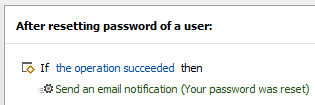

Thank you. When the password is randomized, how do I capture it to be sent to the user?
It can be done using a business rule triggering After resetting password of a user like below. In the email notification template, use the %unicodePwd% value reference to include user passwords.
