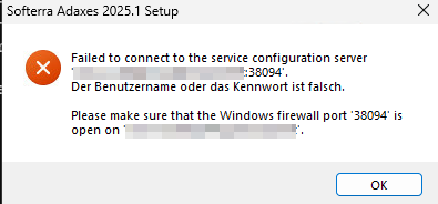

When tryin to add a new server to a current shared configuration, i get a "Failed to Connect to Service Configuration Server", Username or Password wrong. I checked the password, it's correct and i can log on with that account and also the service is running in that context on the server i want to join the shared configuration. The servers are in the same network and no windows firewall is running. I also tried it with domain\username and username@domain, both with the same error. 2025-10-14 10_02_50-.png
Any ideas on that?
by (170 points)
First of all, make sure that all the ports used by Adaxes are open for the computer where the new Adaxes service will be installed. For details, see https://www.adaxes.com/questions/20/what-ports-does-adaxes-use.
Also, you need to make sure that all the ports for AD LDS (used as Adaxes backend) replication are also open. For details on the ports, have a look at the following Microsoft article: https://docs.microsoft.com/en-us/previous-versions/windows/it-pro/windows-server-2008-R2-and-2008/dd772723(v=ws.10)?redirectedfrom=MSDN.
Pay attention that not only firewall, but some third-party software (e.g. protection one) can block or consume the ports.
Finally, make sure that the account you specify during the installation is not a member of the Protected users group.
by (170 points)
I will check that. The user is at least not a member of the Protected User group. And just to be more specific, the server i try to add in the shared configuration, has previsiously already been an Adaxes Server. I just uninstalled Adaxes before to install the new Updates and re-add this server again in the shared configuration.
by (170 points)
I figured out what the problem is. We also did install Windows Updates with our Adaxes Update Process. This made us dive into an error described here:
https://learn.microsoft.com/en-us/answers/questions/5545056/%2824h2%29-build-26100-5074-%28kb5064081%29-release-previe
https://learn.microsoft.com/de-de/answers/questions/5543276/kein-rdp-oder-file-share-mehr-nach-letzten-windows
It's found in KB5064081, KB5064401, KB5065426 and leads to an lsasrv event id 6167.
After uninstalling the KB everything works as expected. Thanks for your assistance.
