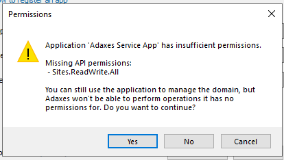

I am attempting to reset the client secret for the Application Registration for Adaxes. I have copied the client secret value from the new secret and using the same App Registration as before with all the permissions originally set. After several minutes of it claiming the client secret is wrong, now it complains:
by (110 points)
The warning is based on the information returned by Microsoft Entra. Most probably, there is some delay caused by the update of the client secret or something else related to replication on Microsoft side. You should be fine with clicking Yes and keep using Adaxes with the new client secret.

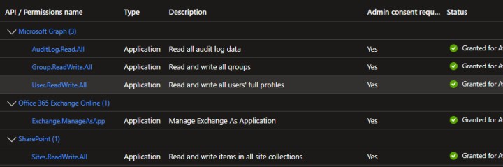

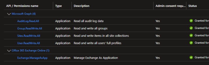

I assumed that at first too, but this was errors even an hour after creating the secret.... What I ended up doing was Remove Permission then Revoke Admin Consent on the existing SharePoint > Sites.ReadWrite.All and readded it, but it now shows up under Mircrosoft Graph
After this the warning dissapeared and was able to connect to the App Registration. Everything appears working now.
