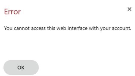

I am looking for a way to view the exact reason why someone would see the error below when accessing the web interface.
It would be helpful to see this in a log somewhere to help me find what setting is wrong, so I don't have to rip everything apart to find the reason. The logs available in reports do not show this information.
So I am hoping to find something that says "user attempted to access Web Interface section A, but is lacking the permission XYZ..."
by (580 points)
The error only occurs when a user attempts to access a web interface they are not allowed to sign in into. At the same time, option Hide error details and remaining attempts on sign-in failure must be disabled.
However, the attempt does not create a log record in Adaxes. Thank you for the suggestion. We forwarded it to the corresponding department for consideration.
