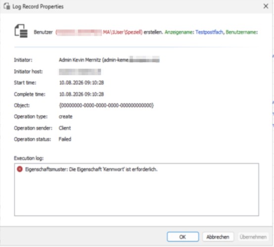

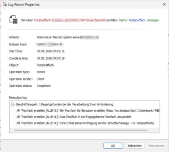

We have mapped multiple locations to multiple OUs in our Active Directory. The issue is that when creating mailboxes, Adaxes returns an error for exactly one OU. The settings are the same for all OUs in both the web configuration and the Adaxes Administration Console. I don't understand why it isn't working for exactly one OU. here it doesn't work: adaxes_mailbox_fail.png and another OU, it works: adaxes_mailbox_works.png I don't know what i can do.
by (190 points)
According to the error, user creation failed because the Password property is set as required, but was not specified during user creation. Making a property required is possible using property patterns. the following tutorial will be helpful: https://www.adaxes.com/help/MakePropertyRequiredAndSpecifyFormat.

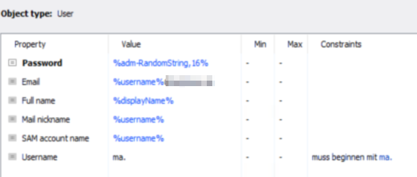

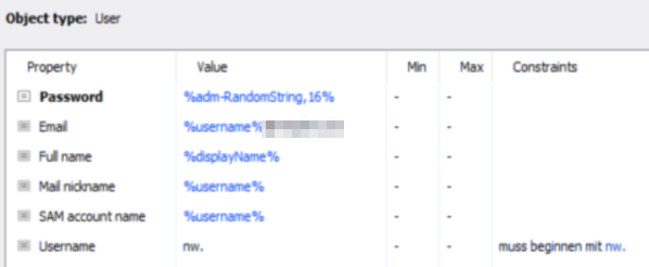

I know what you mean, but the properties and anythingelse are the same. NW works adaxes_mailbox_properties_nw.png MA failed adaxes_mailbox_properties_ma.png
That is correct. As you can see, the Password property is required (marked in bold). Most probably, the failed user creation was somehow initiated without specifying a password.
by (190 points)
hello, but i don't know, why it doesn't work. do you have any ideas? the process is the same like others, but only one process doesn't work.
To help us troubleshoot the issue, please, send us (support@adaxes.com) a copy of the Adaxes event log in EVTX format from each computer where Adaxes service runs. For information on how to view the log, have a look at the following help article: https://www.adaxes.com/help/ServiceEventLog.
