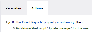

Hello Bernie,
Unfortunately, there is no possibility to have such an interaction. As a solution, you can use an AD object picker parameter in your deprovisioning Custom Command. The parameter will specify a user that will be set as manager for direct reports of the deprovisioned account if it has any. To update the manager, use the below script. In the script, the $newManager variable specifies the name of the Custom Command parameter used to specify the new manager with the param- prefix.
$newManager = "param-NewManager" # TODO: modify me
# Get new manager DN
$newManagerDN = $Context.GetParameterValue($newManager)
# Get user subordinates
$subordinateDNs = $Context.TargetObject.GetEx("directReports")
# Update manager for subordinates
foreach ($subordinateDN in $subordinateDNs)
    $subordinate = $Context.BindToObjectByDN($subordinateDN)
    # Update manager
    $subordinate.Put("manager", $newManagerDN)
    # Save changes
    $subordinate.SetInfo()
The Custom Command will look like the following:
For information on how to use parameters in Custom Commands, have a look at the following tutorial: https://www.adaxes.com/tutorials_Active ... ommand.htm.
