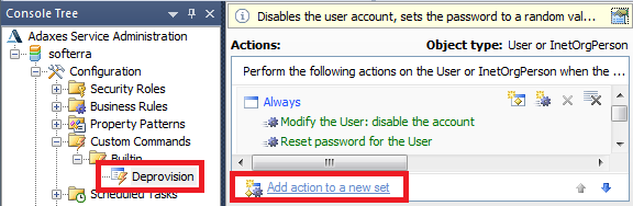

  2. Expand the service node that represents your Adaxes Service.
  3. Navigate to and select the Custom Command that you use for deprovisioning users.
  4. Click the Add action to a new set link.

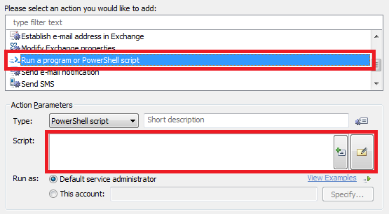

  5. Select the Run a program or PowerShell script action.
  6. Paste the following script to the Script field. It will initiate mailbox export to a PST file, set a flag indicating that the user's mailbox is being exported and store the initiator's e-mail.

  7. In the script:
    • $exchangeServer - specifies the Fully Qualified Name (FQDN) of the computer where your Exchange Server is installed,
    • $filePath - specifies a template for the PST file path,
    • $waitTime - is the time (in milliseconds) to wait for mailbox export to complete before the export process to be considered too long.
    Modify the script to your requirements.
  8. Enter a short description for the script and click OK.

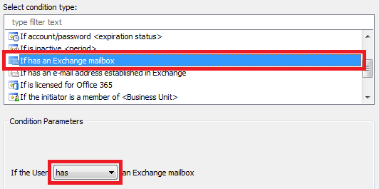

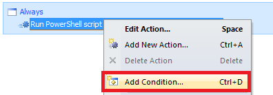

  9. Also, you need to add a condition for this action to be triggered only if the user has an Exchange mailbox. Right-click the action that you've just added and click Add Condition.
  10. Select the If has an Exchange mailbox condition type.
  11. Select has.
  12. Click OK and save the modified Custom Command.

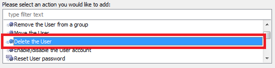

Create a Scheduled Task that deletes the user account after the export is complete
To create such a Scheduled Task:
  2. On the 3rd step of the Create Scheduled Task wizard, select the User object type.
  3. On the 4th step, add the Delete the User action.
  4. Click OK.

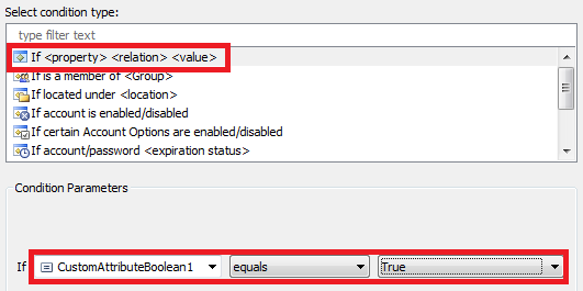

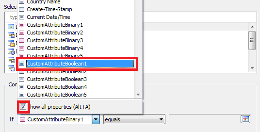

  5. Now, you need to add a condition for this action to be triggered only if the flag for the user is set. Right-click the action that you've just added and click Add Condition.
  6. Select If condition type.
  7. Expand the drop-down list.
  8. Select the CustomAttributeBoolean1 property.
  9. Select equals and True.
  10. Click OK.

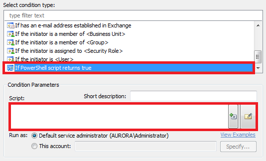

  11. Also, you need to add a condition for this action to be triggered only if the mailbox export has been completed. Right-click the action and click Add Condition.
  12. Select the If PowerShell script returns True condition type.
  13. Paste the following script to the Script field. The script will return True only when mailbox export completes successfully.
