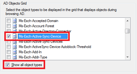

I. Configure the Web Interface to display objects of the msExchActiveSyncDevice type.
For information on how to accomplish this task, see the Manage Active Directory Objects of a Custom Type Tutorial. Use it as a guide.

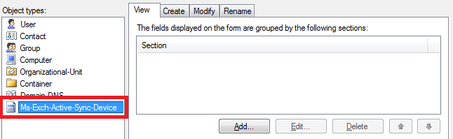

  • On step 4 of the tutorial, select the ms-Exch-Active-Sync-Device object type.
  • On step 5, also select the ms-Exch-Active-Sync-Device type.
