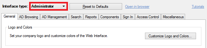

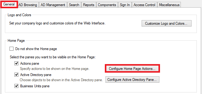

  1. In the Interface type drop-down list of the Web Interface Customization tool, select the Web Interface in which you've created the Home Page Action.

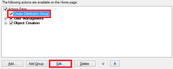

  2. On the General tab, click Configure Home Page Actions.
  3. Select your Home Page Action and click Edit.

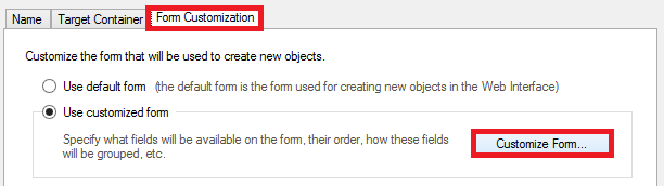

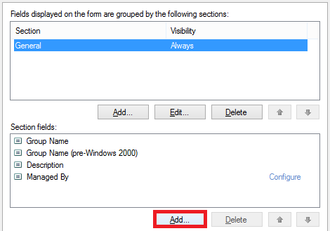

  4. Activate the Form Customization tab.
  5. Click Customize Form.

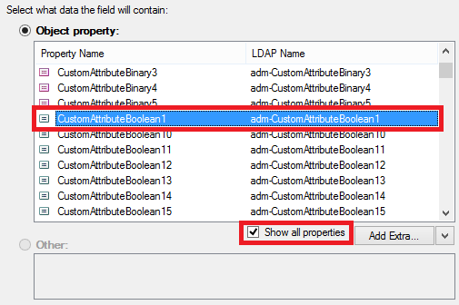

  6. In the upper list, select a section where you would like to add the boolean field.
  7. Click the Add button located under the lower list.
  8. Select Show all properties a and select a custom attribute that you want to use, for example, CustomAttributeBoolean1.
  9. Click OK 4 times, then click Apply.

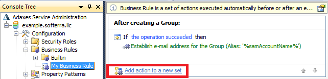

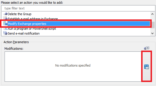

  1. In the Console Tree of the Administration Console, navigate to and select your Business Rule. The actions and conditions of the rule will be displayed in the Result Pane (located to the right).
  2. Click the Add action to a new set link.

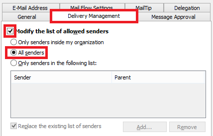

  3. Select Modify Exchange properties and click the Exchange properties button.

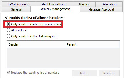

  4. Activate the Delivery Management tab.
  5. Activate the Modify list of allowed senders option.
  6. Select All senders.
  7. Click OK 2 times.

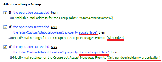

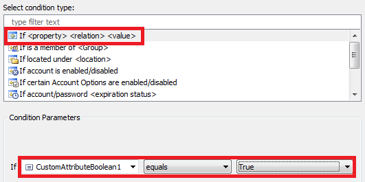

  8. Right-click the action you've just added and click Add Condition.
  9. Select If .
  10. Specify If CustomAttributeBoolean1 equals True, where CustomAttributeBoolean1 is the custom boolean attribute that you've used on the Home Page Action form.
  11. Click OK. This will enable the Require All Senders are Authenticated option when the boolean attribute is set to True.
  12. Repeat steps 2-5.
  13. Select Only senders inside my organization.
  14. Click OK 2 times.
  15. Right-click the action you've just added and click Add Condition.

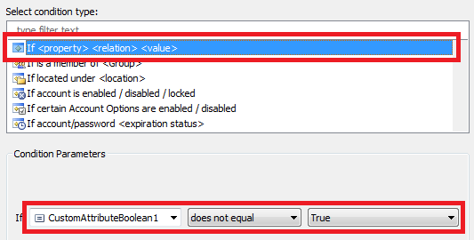

  16. Select If .
  17. Specify If CustomAttributeBoolean1 does not equal True.
  18. Click OK. This will disable the Require All Senders are Authenticated option when the boolean attribute is not set to True.
  19. With the help of the arrow buttons at the bottom, make sure that both the sets that you've added are triggered after a group is mail-enabled. You should receive something like this:
