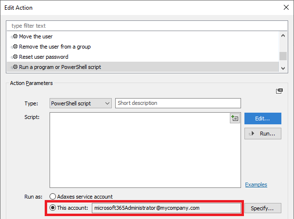

Has anyone found a proper way to connect to Teams powershell and run basic commands?
Currently, it is possible to connect to Microsoft Teams using only the credentials of a user account. The credentials can be specified in the Run As section of the Run a program or PowerShell script action using the This account option. image.png
