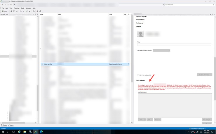

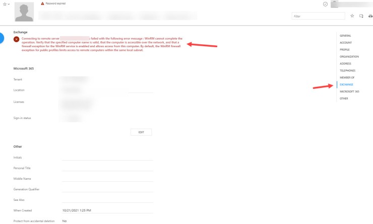

We have made the exact change in our hybrid environment and turned off our on-prem exchange server.
We have a different scenario; we stumbled across a user that shows an error when we look at its exchange properties in the Adaxes Admin web and the Adaxes Console. Screenshots below.
  1. If we apply the same $false values from the ‘Change when remote mailboxes are enabled and disabled’ article, will that resolve our situation?
  2. Is there a script that we can run to see if there are more user exchange properties with this same error?
ADAXES ADMIN WEB ERROR:
ADAXES CONSOLE:
The issue you are facing cannot be resolved by disabling the feature. It is just not related to it. For troubleshooting purposes, please, enable tracing of requests sent to Exchange servers, reproduce the issue and send us (support@adaxes.com) the log file. For information on how to enable the tracing, have a look at the following help article: https://www.adaxes.com/help/EnableExchangeRequestLogging.
