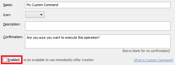

To create the command:
  2. Since, most probably, you are not going to execute the command manually, you may want to clear the Enabled option on Step 1. This will create the Custom Command in disabled state. Disabled commands are not visible anywhere in Adaxes UI, but can be used in Business Rules, Scheduled Tasks and other Custom Commands.

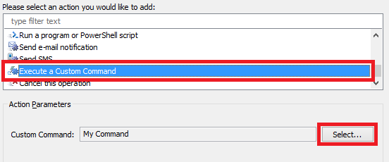

  3. On Step 3, add the Execute a Custom Command action.
  4. Click Select and select the Custom Command you created on step i.
  5. When done, click OK 2 times, then click Next

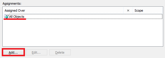

  6. On the final step, add All Objects to the Activity Scope of the rule.
  7. Click Finish.

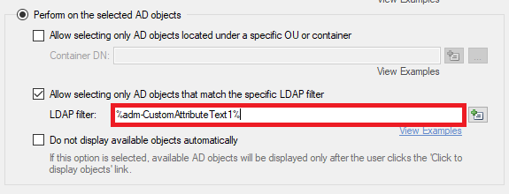

iv. Add a value reference for the attribute where the script saves the LDAP filter to your Home Page Action configuration.
Now, to use the filters in your Home Page action, you need to type a value reference for the attribute you used in $propertyForLDAPFilter (step i.5) as the filter value for selecting Organizational Units in your Home Page Action configuration.
