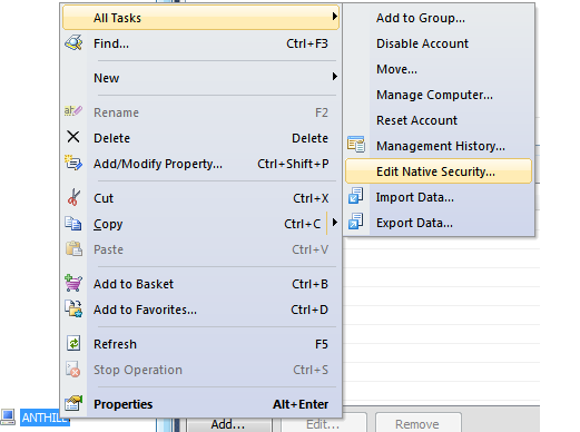

Please open the Permissions dialog for the computer and make sure there are permissions for the user in that dialog.

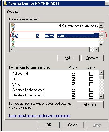

The account that was assigned appears to have full permissions on the computer account.
Sorry for the delay. The fact that the account has Full Control rights for the computer, means that the user must be able to join the computer to a domain. Our QA team will investigate the possible reasons for why the user receives the Access is Denied error. I'll update this post as soon as they get any results.

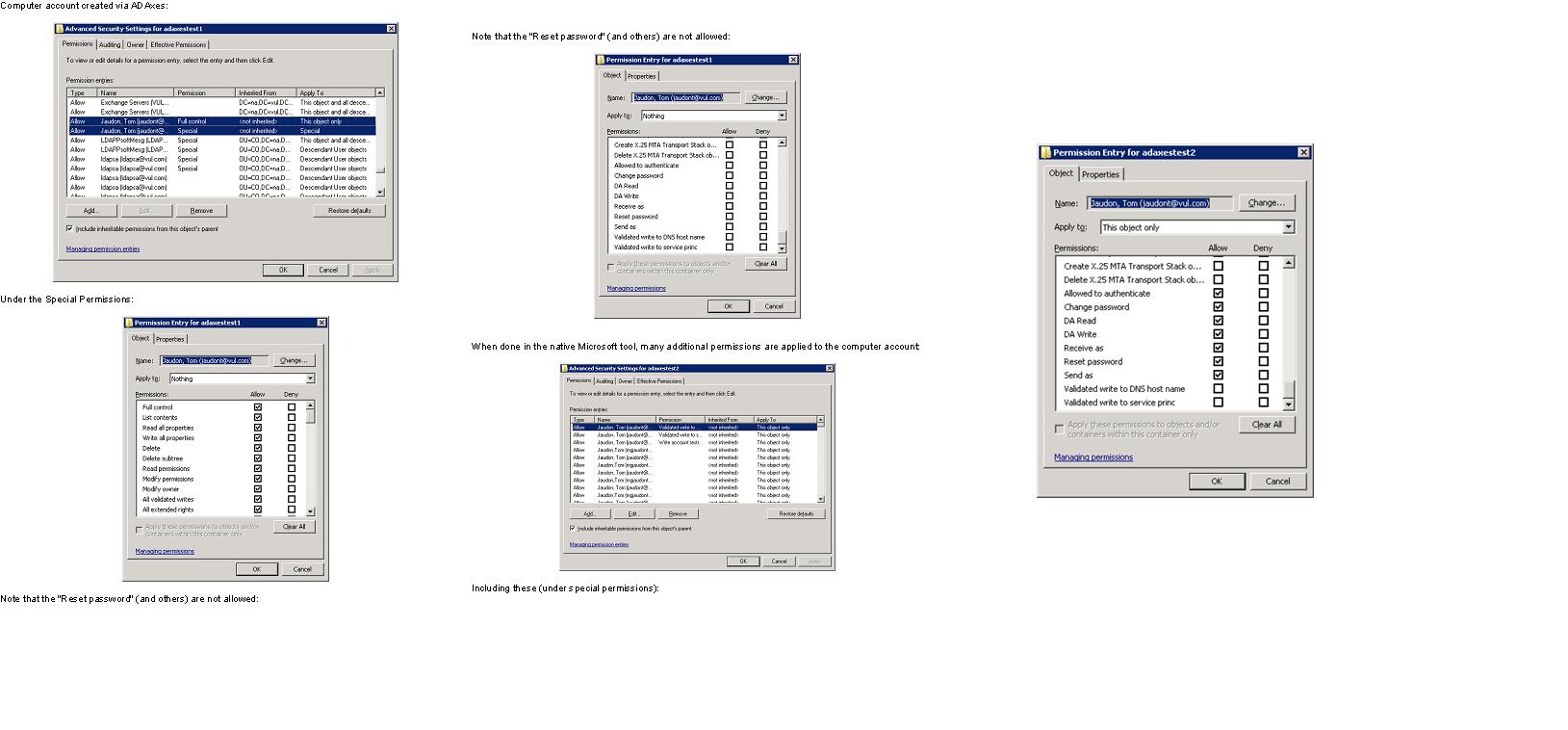

I've attached some additional information and findings. It appears that ADAxes is not granting sufficient permission to fully add a computer account in our domain.
Also, I would point out that if I add at least the "Reset password" permission manually to the delegated account after creating it with ADAxes, the user is then able to add the computer to the domain.
