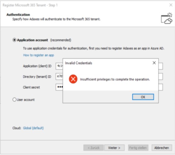

I try to registrer Adaxes with M365 with using your manuel: https://www.adaxes.com/help/RegisterAdaxesAsAppMicrosoftAzure/
if i try to connect from adaxes administration console, i get the message below.
I enter the application ID, Direction ID and client secret, but can't connect.
which credentials are invailid?
by (150 points)
The error is about the permissions granted to the application in Microsoft Entra. Make sure grant all the permissions mentioned in the article and add admin consent. Pay attention that the permissions must be of application type, not delegated.
As an easy option, you can use the script from section Quick app registration with a script.
by (150 points)
Thanks after setting alle API Premisions etc, it works.
