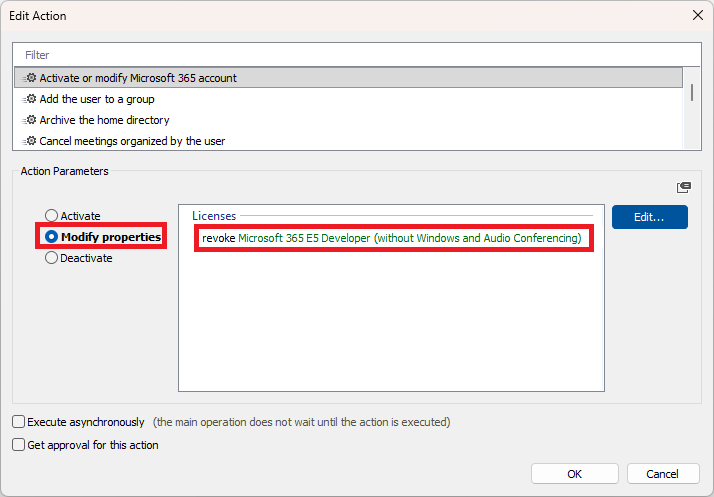

Unfortunately, that is another example where AI references a functionality that simply does not exist. There is no possibility in Adaxes to check whether a Microsoft 365 license is assigned directly or based on group membership. The AssignedInGroup property does not exist. It can only be done by directly connecting to Microsoft 365. Moreover, methods GetLicenses and RemoveLicense do not exist in Adaxes.
Do we understand correctly that you mean the Microsoft 365 licenses that are assigned automatically based on group membership? If that is correct, there is no built-in functionality to skip such licenses or suppress the corresponding errors. As a workaround, you can use the Modify properties option of the Activate or modify Microsoft 365 account action. In this case, you can explicitly specify the licenses to be revoked. image.png
