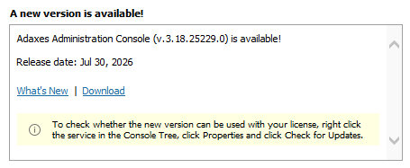

When we try to upgrade Adaxes to 2026.1 its asking to remove the present version 2025.1. We would like to know if we uninstall & install 2026.1 do we lose our configurations & Scripts ?
And Licensing Infomation / File image.png

Adaxes does not support in-place upgrades. You need to back up your current configuration, uninstall the version you are using, install the new version, and then restore the backup. For upgrade instructions, have a look at the corresponding section of the installation guide: https://www.adaxes.com/help/InstallationGuide/#upgrade. Additionally, make sure you have a copy of the Adaxes license file before the upgrade. Unfortunately, there is no possibility to extract an activated license key. If you do not have a copy, you can contact your Account Manager at sales@softerra.com and request sending you the latest license key.
