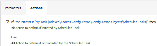

Can I get some help with a PowerShell if statement? I'm looking to write something like If the script/custom command is fired via a scheduled task do this. If/Else the script/custom command is fired manually against a user do this.
I was thinking I could do something like this but I'm getting an error that TaskName property cannot be found in the cache when running the custom command against a user.
if ($Context.Initiator.UserAdsObject.Get("TaskName") -eq "My Scheduled Task") {"Do Something"} Else {Do Something Different"}

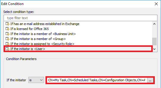

Hello Ryan,
This can be done using the If the initiator is condition in your Custom Command. No PowerShell scripts are required. In the condition, you will need to use the distinguished name (DN) of the Scheduled Task. For information on how to get the DN, see https://www.adaxes.com/sdk/?HowDoI.GetDnOfObject.html.
Finally, the Custom Command will look like the following:
