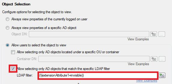

  1. To configure the Home Page Action to allow viewing users, on Step 1 of the section, select View and User from the associated drop-down list.
  2. On Step 3 of the section, select the Allow selecting only AD objects that match the specified LDAP filter option and specify a LDAP filter that will be used to return only actual users. For example, to return only users whose Extension Attribute 1 is not set to invisible, specify the following filter:
     (!(extensionAttribute1=invisible))

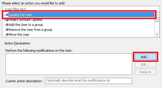

  2. On the 3rd step of the Create Scheduled Task wizard, select the User object type.
  3. On the 4th step, add the Update the user action and click Add.

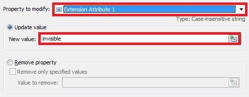

  4. In the Property to modify field, select the property that you need, for example, Extension Attribute 1.
  5. In the New value field, specify the predefined value that you want to use, for example, invisible.
  6. Click OK.
