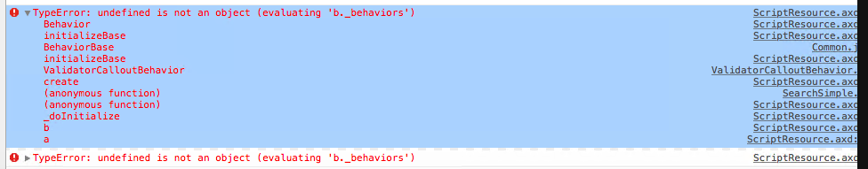

Yes our web interface works in other browsers and works on Safari 7 okay too. An example of an issue is Search. The page sits at the Loading... spinner and doesn't return any results. If I look in the Console window there are errors displayed (screenshot attached)
The reason for the issue is that ASP.NET that used as the engine for Adaxes Web Interface does not correctly recognize the Safari 8 browser. To quickly fix the issue, do the following:

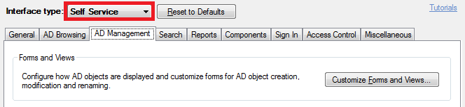

The solution we provided above didn't work because IIS didn't recompile the web site for the Adaxes Web Interface. An IIS restart doesn't always cause a site recompile.
To resolve the issue:
  1. Perform the steps listed in OSX Yosemite.
  2. Start the Web Interface Customization tool.
  3. In the Interface type drop-down list, select the Web interface you are having issues with.
  4. Make any changes to the Web Interface. For example, enable or disable the home page.
  5. Click Apply. This will force IIS to recompile the web site.
  6. Undo the changes that you've made and click Apply again.
This should resolve the issue.
