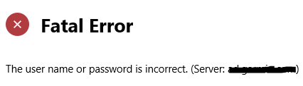

I am seeing this error in our logs and while it seems straight forward that it is wanting me to back up, I am not sure how to do this. We have 3 other servers in the configuration that are not getting this error. I am not sure if it is related but I found this error because when I open up Web Interface Configurator on this server, I get "Fatal Error: The username or password is incorrect. (Server: ***)
How can I resolve this warning in the event logs and/or the Web Interface Configurator error?
  • Does sign in to Adaxes Web Interfaces work fine?
  • Do you have Auto Logon enabled for the Web Interface Configurator?
  • For troubleshooting purposes, please, send us (support[at]adaxes.com) a copy of Adaxes Event Log. For information on how to view the log, have a look at the following help article: http://www.adaxes.com/help/?ServiceAdministration.ServiceEventLog.html.

Thanks for your help. After opening a ticket, it was determined that the application pool was running as ApplicationPoolId instead of NetworkService.
