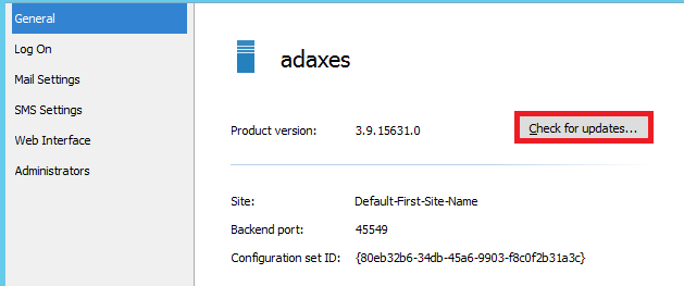

You can check for updates using Adaxes Administration Console manually:
  2. In the Console Tree, right-click the service node and click Properties in the context menu.
  3. On the General tab, click Check for Updates.
  4. If a new Adaxes version is available, the corresponding notification will be displayed in the dialog box that opens.

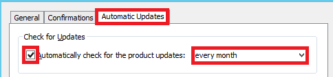

To automatically display a notification in the Output pane when the Administration Console starts if a new version of Adaxes is available:
  2. In the main menu, click Tools.
  3. In the drop-down menu, click Options.
  4. Activate the Automatic Updates tab.
  5. Select Automatically check for the product updates and then select the required period.
  6. Click OK.

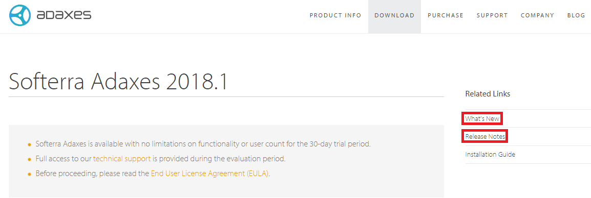

Release notes are available for each Adaxes version on our site. However, they do not include information about updates, it is available in the What’s New section.

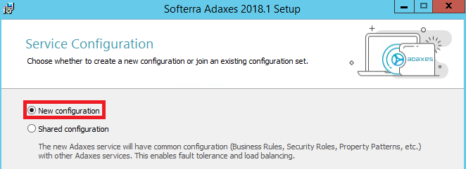

Hello Sandra,
For the new installation not to influence your production Adaxes configuration, install the latest version without sharing configuration with the production one. To do so, select New configuration on the Service Configuration page of the installation wizard.
As long as your instances of Adaxes service will not share configuration, you won’t be able to apply the same license key for the new version. However, you can install a 30-days free trial of the latest Adaxdes version on your VM and play with it.

For a new instance of Adaxes service to share common configuration with an existing instance, you need to select the Shared configuration option during the new instance installation. You can check details in our Installation Instructions: https://www.adaxes.com/resources/releas ... lti_server.
License key is not included into the backup. You need to activate it manually on each computer where Adaxes service is installed.
