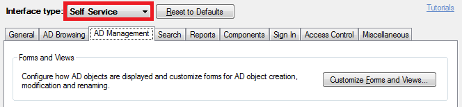

The issue can persist because the IIS didn't recompile the Web interface site after you've made the fix, and thus the fix didn't apply. To apply it, you need to force IIS to completely recompile the site for the Web Interface. To do this:
  1. Start the Web Interface Customization tool.
  2. In the Interface type drop-down list, select the Web interface you are having issues with.
  3. Make any changes to the Web Interface. For example, enable or disable the home page.
  4. Click Apply. This will force IIS to recompile the web site.
  5. Undo the changes that you've made and click Apply again.
