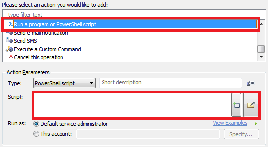

To execute the task when deprovisioning users, you can add the script to the Custom Command that you use for deprovisioning. By default, built-in Custom Command Deprovision is used for this purpose. For information on how to add an action to this Custom Command, see step 5 in the following tutorial: http://www.adaxes.com/tutorials_ActiveD ... ioning.htm. You need to add the Run a program or PowerShell script action and paste the above script in the Script field.

To be able to restore group memberships of the users whom you want to re-provision, you need to create a Custom Command that can run the script on a user account. For information on how to create Custom Commands, see the following tutorial: http://www.adaxes.com/tutorials_ActiveD ... ommand.htm. Use it as a guide. On step 4, add the Run a program or PowerShell script action and paste the script in the Script field.
