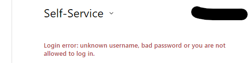

Here is the error: image.png
The trace log just says the same thing.
I tested that I can edit properties on the domain through adaxes and save them successfully.

  • Screenshot below of the error: image.png
Hello Mark,

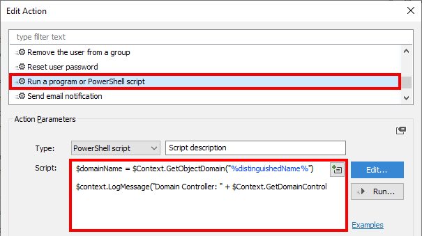

Thank you for the provided details. According to the error message in the screenshot, the specified password does not match the username. Please, try to sign in using the credentials that are confirmed as valid on the domain controller (DC) the Adaxes service is connected to. To validate the credentials, you can use them to connect to the DC via Active Directory Users and Computers. To find out which DC Adaxes is using for a domain, create a Custom Command as follows and execute it on any user from the domain you need. The DC will be displayed in the Execution Log after the command completes.
To create the Custom Command:
  3. In the context menu, navigate to New and click Custom Command.
  4. On step 2 of the Create Custom Command wizard, select the User object type and click Next twice. image.png
  5. Click Add an action.
  6. Select Run a program or PowerShell script and paste the following script into the Script field: image.png
$context.LogMessage("Domain Controller: " + $Context.GetDomainController($domainName), "Information")
  1. Enter a short description and click OK.
  2. Click Next and finish creating the Custom Command.
I have followed your instructions and double checked that I can sign in to the DC that it is connecting to. I tested all my DCs in that secondary domain. My password works there but not in Adaxes web interface. Is there another way we can test where the web interface is connecting to? A log that shows the attempt?

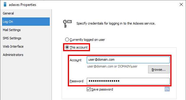

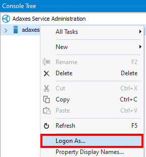

Thank you for the provided details. Could you, please, clarify whether the domain where the Adaxes services run and the domain the issue persists with are in the same forest? Do we understand correctly that your account resides in the secondary domain and you can logon to Adaxes service via Adaxes Administration Console but cannot perform the logon via Adaxes Web Interface? To check whether an account from the secondary domain can logon to Adaxes service via Adaxes Administration console, please, do the following:
  4. Select This account and specify the credentials of an account from the secondary domain. image.png
  5. Click OK.
They are separate forests. The domains have no trust between them at all. We connect to the domain using different service credentials and I tested my account by using it to connect to the domain.
To do this, I right clicked the domain and selected "Change logon information"
Following your instructions about didn't work but i think that is because the service is not using that domain but our primary domain.

They are separate forests. The domains have no trust between them at all. We connect to the domain using different service credentials and I tested my account by using it to connect to the domain. To do this, I right clicked the domain and selected "Change logon information"
Thank you for the clarification. The check that you performed does not test Kerberos because the authentication that is performed via the Change Logon Information option uses LDAP.
The logon to the Adaxes service did not work because Kerberos authentication cannot be performed for the accounts of your secondary domain. When Kerberos works, logon to an Adaxes service should be possible using the credentials of any enabled, not expired and not locked account managed by the service.
We need to schedule a call on this one for you to truly understand how we have it set up.
