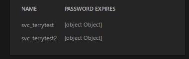

I added a chart based on report "soon-to-expire passwords" to the homepage. In Adaxes console, it will show a chart with time/date of when the password will expire. In the web interface, it shows the account name but under "password expires" it shows [object Object]. If I run the report in web interface, it will show data but the chart will still be blank. charts.jpg

For troubleshooting purposes, please, post here or send us (support@adaxes.com) a screenshot of the steps you took to add the report to the Web interface home page. Any additional details will be much appreciated.

I was able to resolve this issue by changing the "items sorted by" value from "Password Expires" to "PasswordExpires". The first value had a green box, which didn't work.
